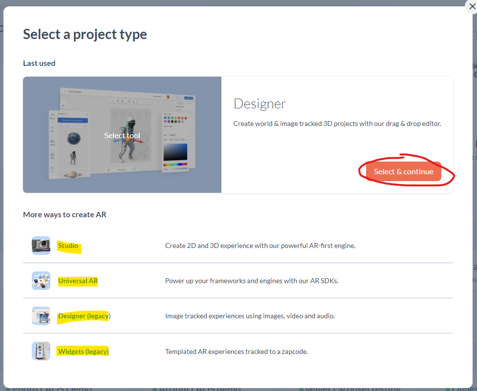

If you are using ZapWorks Studio or the Universal AR SDKs, you can start a project by launching the corresponding app/software. With Studio, simply open the app and click “New Project” from the launcher menu. Circled below. Universal AR I am less familiar with, but I imagine you can open whatever environment you use to code and hop right in.
If you use ZapWorks Designer, you will need to create a trigger (i.e. a QR code, deep link, or ZapCode) first. You can also follow these steps to create a trigger for a Studio or Universal AR as well so that you have a place to publish your finished project to.
First, go to my.zap.works and log in. Then, click the orange “+” button near the top of the projects list, circled below.
From the popup, choose which tool you plan on using. This cannot be changed later.
Next, select which trigger you want. For WebAR, use a QR code or deep link. You can add more triggers later.
You will then be taken to the project page. If you’re using designer, you’ll see a button on the top section that says “open designer”. Click that button to open Designer and begin your project. If you chose Studio, it will say “Download Studio”.
